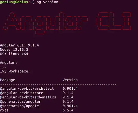

After installing AngularJS check with: ng version
The result should be like this: enter image description here
