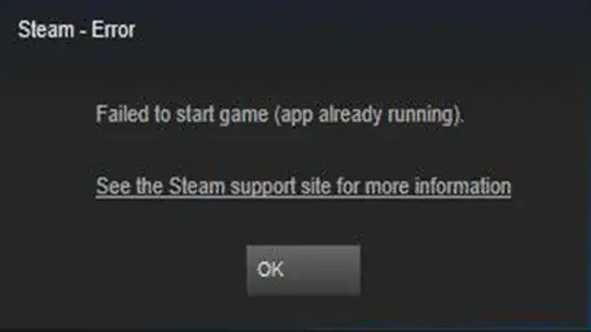

I have a game, game lags, I can't close it normally, im forced, to use forced kill, in this scenario xkill should be good but when I close a game (in steam), steam still thinks that game is opened, and I can't launch it again.
Error that is shown
Any solutions? And please no answers like reboot, because it's not I'm focused to.
