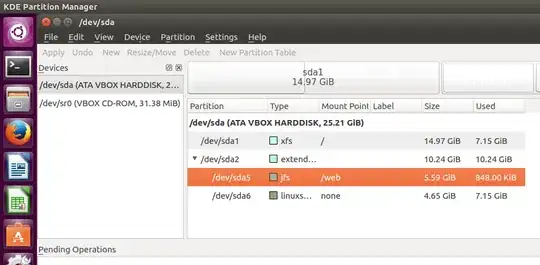

To this avail, I created a Ubuntu 16.04 VM in VirtualBox, and I manually partitioned the disk on startup (of Ubuntu-Install), into a 15 GB root partition, 4 GB Swap-Partition and 6 GB JFS partition.
This looks like that
Initial Config

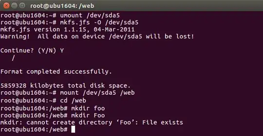

So after everything is installed, and the operating system is rebooted (successfully), I unmount the partition
umount /web
And recreate it with the -O option (=OS2-compatiblity = case-insensitive)
mkfs.jfs -O /dev/hda5
It says: this will delete all content, I choose [YES].
then I re-mount that filesystem:
mount /dev/hda5 /web
After /web is mounted, I create a file/folder called "Test" into /web, and then I try to create another file/folder called "test" in /web, and then it says: error, file already exists.
Superb, works as it should - file-system is case-insensitive.

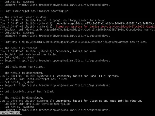

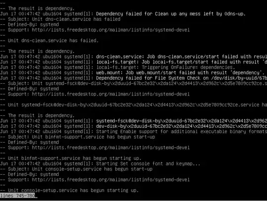

But when I restart, I get
Welcome to emergency boot mode...
and then, you basically can't do anything except deleting the VM, and re-importing the backup copy.
Why do I get emergency-boot-mode ?

is /web partiton automatically mounted? when you remake the partition it changes the uuid you have to update /etc/fstab with the new uuid.
EDIT: yes I see the lines, the system is crashing because it can't find /web by uuid. and since it is in fstab it is considered a dependant mount.
