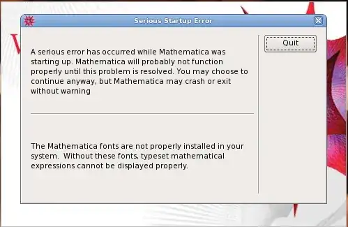

  1. All software works great, including MATLAB, but Mathematica refuses to open. It also refused to do so over X. Here's the error message: mathematica error message

You could try to install the package mathematica-fonts on your laptop, to resolve the first problem.
