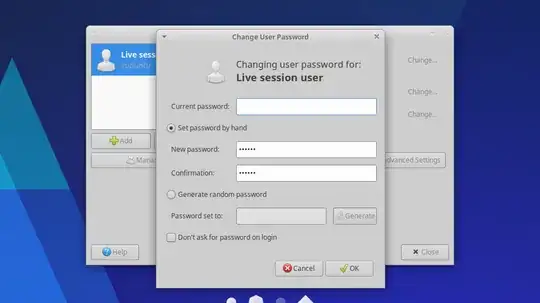

I installed Xubuntu on a pen drive to use as live (with persistence) and I cannot put a password.
It asks to enter the "current password", but I never changed any kind of password.
user settings screenshot
I've tried to leave it blank, but it will not accept that. I also tried to create another user with password, and it worked, but the system does not connect directly to it on boot. And I already tried to delete the user with no password there.

There is no default password for the live user. It is blank. It seems though, that the GUI app you're using doesn't let you leave the password blank.
You can change it by opening a terminal and typing
passwd
It'll also ask you for the current password. Just press enter.

The quick fix is to create another user in your persistent live system. In Lubuntu (and I think also in Xubuntu) there is 'Users and Groups' in the System sub-menu. This menu entry runs the program users-admin, which can be installed with the following command, if it is not already there in Xubuntu,
sudo apt-get install gnome-system-tools
Start 'Users and Groups', select +ADD to add a new user, tick the box to 'Encrypt home folder to protect sensitive data' and fill in 'Name' and 'Username'.
In the next window you should select a good password.
Let the system boot into the standard user (after cold boot or reboot), logout, select the new user and its password and login. Edit: This was fixed by the original poster as described in a comment by removing the live user 'xubuntu' (user #999).
After login you should save the passphrase for the encrypted home, when prompted. And take regular backups because [even with the passphrase] it is difficult to recover the data, if the system is damaged.
You may want 'full access' including running sudo from this new user. You can give such permissions by adding the username to lines in the file /etc/group, with the username 'xubuntu' at the end of the line.

Just go to "Users and Groups" and create a new user. Open terminal and add to sudo group
sudo usermod -aG sudo <your-new-username>
Logout, and login as new user. Delete default user
sudo userdel xubuntu
if you get an error about process being used do
sudo kill -9 process-Number-Listed-by-error
then again sudo userdel xubuntu and finally kill home dir of default user
sudo rm -rf /home/xubuntu
Now you are running fresh user with password
