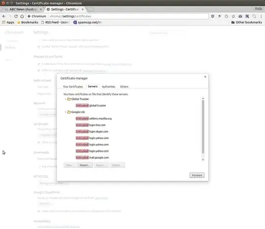

I am using Ubuntu 16.04 LTS and I am experiencing expired certificate issues (mainly with Google sites). I have followed the steps (without error) in Problem with certificates and this does not resolve the issue. Obviously I am unable to connect to any Google site to obtain assistance there and would appreciate any help. I have attached a screen shot of the Untrusted Certificates appearing in Chrome. I am getting these errors in firefox on my ubuntu box and my windows machines. I have also taken a look at Fake UserTrust.com Certificates in Chrome? but there did not appear a resolution implied. Thank you in advance. Apologies for forgetting the attachment.
Screen shoot of chrome untrusted certificates

Thank you for the assistance. I have been able to gain a solution by taking a broader view. Given that the issue was affecting all devices behind my router I began examining here and found the culprit. I have a Draytek router which had recently been firmware update. The issue was that I was blocking a WED HD Google service, apparently under the updated firmware it block more than WEB HD. I will be following up with Draytek to obtain further clarification. For community benefit the following is the service block details:- Google Service 1.11.4865.2530 To block Gmail and Google Drive. If user has login, it can not be blocked.
