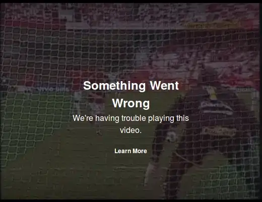

Facebook videos stopped playing but on youtube everything is still fine.
When I play videos on Facebook I get:
"Something Went Wrong, we're having trouble playing this video".

Installing ubuntu restricted extras solved this problem for me
sudo apt-get install ubuntu-restricted-extras
I had the same problem. I fix it like this:
sudo apt-get install adobe-flashplugin
If that's already installed, try to upgrade it:
sudo apt-get upgrade adobe-flashplugin
Diego
  • 31
I have the same problem, and this solution works for me. You can find "Restart with Add-ones disable" in "Help" menu, the firefox will restart with safe mode, check the video works or not, then switch back to see how about it then.
Go to the Ubuntu Software Center and search for codecs and install the GStreamer Multimedia Codecs ( GStreamer OpenCV plugins ) it works for me.
