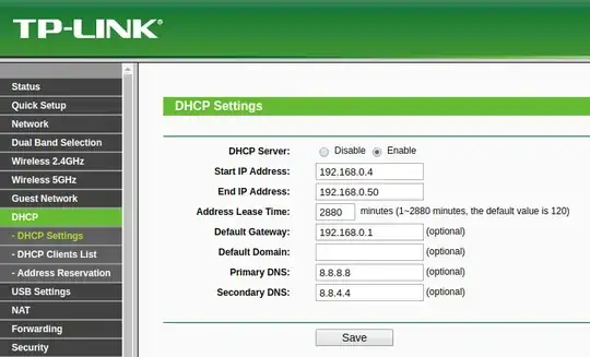

We know that you obtain your IP address, DNS nameservers, etc. from a DHCP transaction with your router, switch or other access point. If yours was a static address, you would have been required to specify the DNS nameservers and you'd therefor already know the DNS servers effectively being used.
In a DHCP transaction, the DNS nameservers in the router are transferred to your connection. In fact, they may come, in turn, from the modem or internet appliance provided by your internet service provider.
You can probably specify the nameservers you prefer by accessing the administration pages of the router like this.enter image description here
