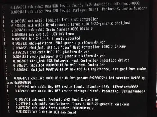

So I have dual boot (win + ubuntu), I shrinked Ubuntu partition, and added these GB's to mine Win partition (through windows disk management), now it shows busybox. Gparted made everything successfully without any errors, system was working fine, but today when I tried to boot it - BusyBox.
Please don't mark this as duplicate because there's no clear answer to this frustrating thing.
Tried boot-repair, did nothing.
