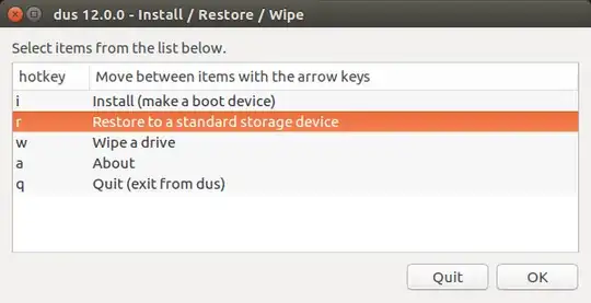

You can use mkusb-dus to delete that Live USB info and restore the USB drive to a standard storage device with an MSDOS partition table and a FAT32 partition.
sudo add-apt-repository universe  # only for standard Ubuntu
sudo add-apt-repository ppa:mkusb/ppa  # and press Enter
sudo apt-get update
sudo apt-get install mkusb mkusb-nox usb-pack-efi
You find more details at these links,
phillw.net/isos/linux-tools/mkusb/mkUSB-quick-start-manual.pdf
help.ubuntu.com/community/mkusb
