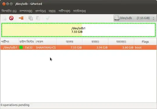

Open Gparted. Unmount your usb disk from gparted. Now repair your usb disk's partition.
[example: /dev/sdb1 not /dev/sdb. Repair partition not the disk].
enter image description here From partition menu(P) and select unmount. Again From partition menu select check. Now apply.

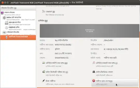

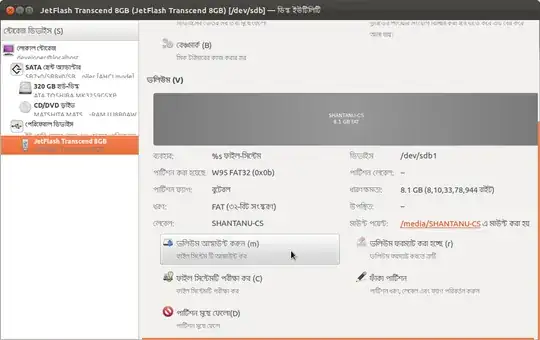

Open disk utility. also insert your usb disk. Unmount the volume(m)
Now Delete the partition(D) enter image description here
Create a partition. Then mount it.
