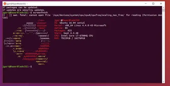

You can setup Ubuntu like colors in Windows Subsystem for Linux as this tutorial describes in detail:
Caveat
Don't use the screenfetch display above, use the modified winscreeny here:
Using this splash screen gives more details than the tutorial's screen and avoids error messages like it has.

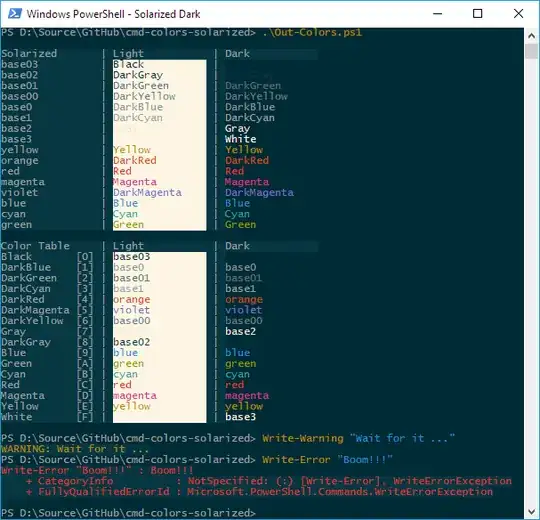

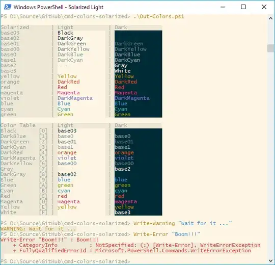

But theming the bash environment is the same as theming the Windows command prompt. There are some themes available, see https://github.com/neilpa/cmd-colors-solarized
dark
Light
