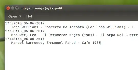

Automatically log all your played songs, with a time stamp
Alternatively, without changing anything to your .desktop file or having to manually log your songs, you can run the background script below. It will create a log file, named played_songs, in your home directory:
Advantages are:
  • Fully automatically logs all your played songs
  • No need to change your .desktopfile, which means it also works when you start VLC from the command line.
Disadvantages are:
  • Although I couldn't measure or see any additional processor load, theoretically it adds some activity. This is practically none though, even on stone-age boxes.
  • From time to (long) time, you will need to "empty" or remove the log file, since (currently) it has no limit in size. This can be easily fixed though if you like.

    Open any song in VLC in either way (cli, gui), the log file should be created and show the logged songs.
