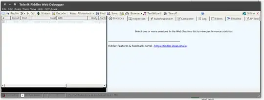

Could anybody show me how to install fiddler on Ubuntu? I need to use it for web development.

First things first:
  1. Install mono:
     sudo apt install mono-complete
  2. Download fiddler for Linux by clicking here and extract it.
  3. Then with mono installed run it with from the extracted directory:
     mono Fiddler.exe
  4. Or run with mono /path/to/extracted/fiddler/Fiddler.exe
Source:
https://www.telerik.com/download/fiddler
http://fiddler.wikidot.com/mono
UPDATE
The fiddler can be gotten from here and installed using the following commands:
  1. chmod a+x progress-telerik-fiddler.AppImage, to make the installer executable, and,
  2. ./progress-telerik-fiddler.AppImage: to install the fiddler.
