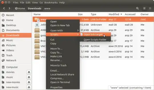

4. Save the file, open Nautilus, 'right click' on some symlink, go to 'Scripts section' and click on 'Open link target':

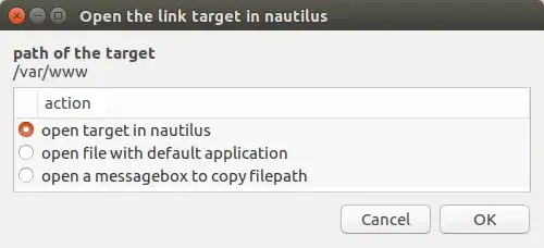

5. Then will be appeared this dialogue box:
