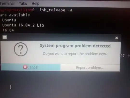

(Edit #1: When I am logged in and then plug in the device, I get the following error dialog just before it freezes and I cannot do anything anymore: enter image description here I know, it does not tell much, but I cannot click or press any keys after that, so I cannot show the details. I also tried to plug it in with all other USB devices disconnected, in case of power supply problem. It does not help.)
