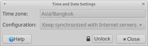

I have 'ntpd' running and in Time/Date settings synchronization is enabled:
$ ps -ef | grep ntp
ntp       1643     1  0 11:20 ?        00:00:00 /usr/sbin/ntpd -p /var/run/ntpd.pid -g -u 121:129
If you DON'T want this enabled, set the Configuration to manual and remove the ntpd package from your system.

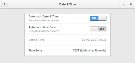

You can see some settings for Time & Date in System Settings. As seen in the picture, you can switch off Automatic Date & Time. This will stop your time synchronization.
