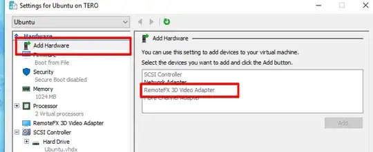

  • Add RemoteFX 3D Video Adapter hardware to the virtual machine running Ubuntu
    screenshot

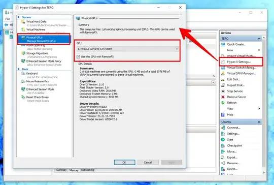

  • In Hyper-V settings, select the GPU to use, and enable it for RemoteFx
    screenshot

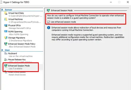

  • In Hyper-V settings, enable the enhanced session mode
    screenshot

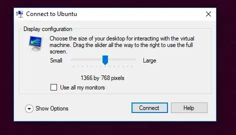

If all went fine, when you restart the Ubuntu virtual machine, you will see the following window.
screenshot

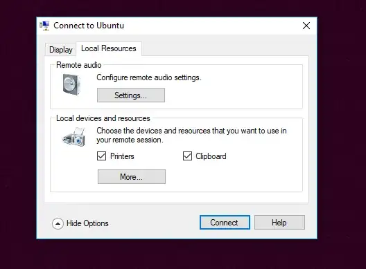

Clicking on Show Options will give you more share options, for example the one for sharing the clipboard (guest to host, and vice versa), or for sharing the printer.
screenshot

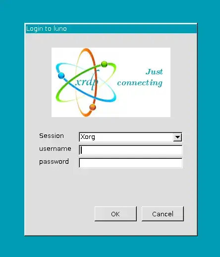

After you click on Connect, you will see the following window, to log in to Ubuntu.
screenshot
