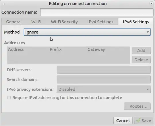

Go into network manager and change the network settings to match the screenshots, to include setting IPV6 to ignore, save then reboot. enter image description here enter image description here
