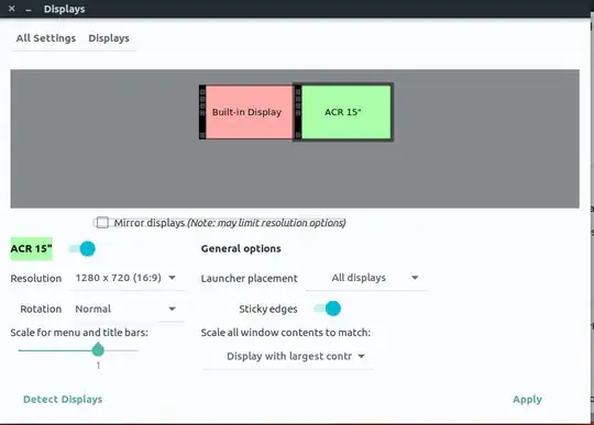

I've just installed Ubuntu 17.04 and it is detecting two displays but I only have one. it's an unpleasant experience because the display that I don't have is considered as primary display so things like "Plank" appear on that display (which I don't have)
Things I've already tried
The first thing I tried is, I hopped over the display section in the settings app and tried to turn the built in display off. setting gets applied for 2 minutes and then resets itself to the initial settings.
Two monitors when only having one in 13.10
The situation in above question is same. but the solution is above question does not work for me.
