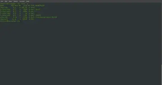

Type lsblk -p. This will give you a list of all of the partitions Ubuntu sees along with the full path to where they're mounted. It should look like this: enter image description here In my case, the USB corresponds to /dev/sdb. Yours may differ. Note that at the end of mount point line for the USB is the USB's name. You can verify this by opening Nautilis ('Files' in Ubuntu) and checking your USB's name. Note that in my screenshot /dev/sda contains branches to /dev/sda1, /dev/sda2, etc. These branches are partitions. You should unmount these before continuing. You can do so by typing umount /dev/sdxx, where the first x is the letter after sd and the second x is the partition number. Once all of the partitions have been unmounted type mkfs.vfat /dev/sdx. NOTE: Substitute x with the letter that you used when unmounting the partitions. This process should reformat your USB as a single partition with the vFAT file system. vFAT is an improved version of FAT and is backward compatible.

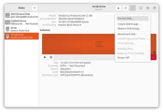

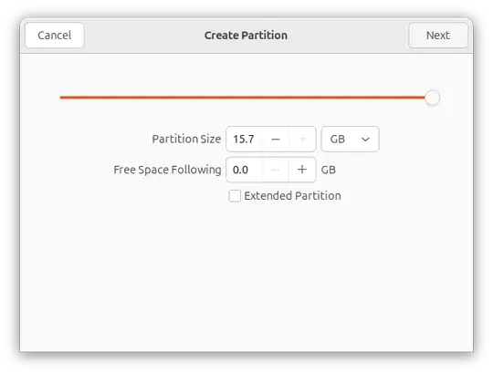

Using the Disks utility or fdisk command to clean the partition table and format the USB flash drive:
A. Using the Disks utility:
  1. Open Disks utility, select the USB flash drive, and from the 3 dots select Format Disk. using the Disks utility 1

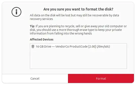

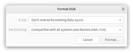

  2. Select the erase and partitioning method, and click Format. using the Disks utility 2
using the Disks utility 3

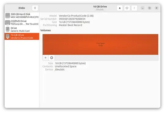

  1. Create a new partition by clicking on +.
using the Disks utility 4
using the Disks utility 5

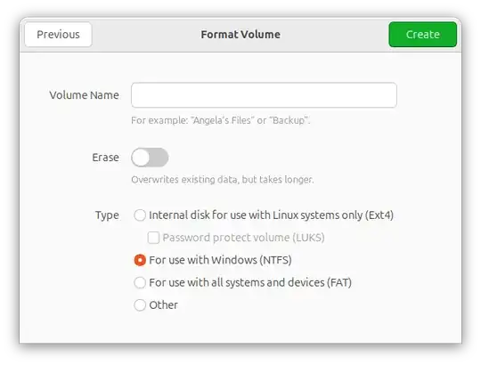

  1. Select the appropriate format type, and click Create.
using the Disks utility 6
  1. Flag the partition as bootable
