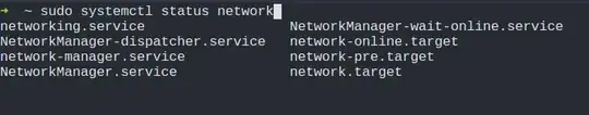

I'm using Ubuntu 16.04 and my Systemd shows both network-manager.service and NetworkManager.service. Are both of these based on the network-manager program or is this something else?

There is no difference.
The unit file for network-manager.service is a symlink to NetworkManager.service.
$ file $(locate network-manager.service)
/lib/systemd/system/network-manager.service: symbolic link to NetworkManager.service
The "two" services are the same process:

The name network-manager remains simply for compatibility, so people can use old style commands like sudo service network-manager restart (sympathy for our muscle memory).
