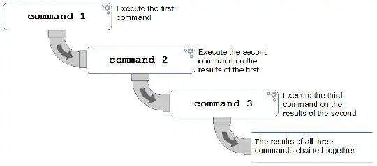

| is called pipe. The pipe operator passes the output of one command as input to another. A command built from the pipe operator is called a pipeline.
In UNIX like operating systems, a pipeline is a sequence of processes chained together by their standard streams, so that the output of each process feeds directly as input to the next one.
Suppose, you have $ command 1 | command 2 | command 3, then
Source: Using Pipes with Linux Commands
