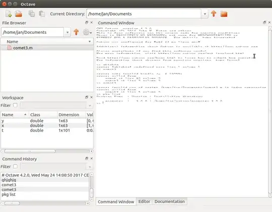

However there is a graphical bug in my Octave terminal:
screenshot of issue
The rows in terminal are stupidly small to see the present code.
How can I get rid of this bug?

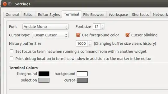

I fixed it by changing the font from Courier to another type. In my case, I changed it to Andale Mono. I have Octave version 4.2.2, and my Ubuntu is 16.04 LTS.
