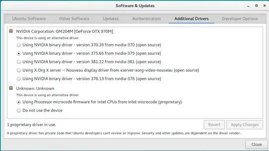

I have notebook MSI GS60 6QE with nvidia 970 + intel 530 graphics, last available version of bios at the moment.
I installed Ubuntu gnome 16.04.2 (kernel 4.8.0-52-generic), with nvidia driver 375 or 378 or 381 (from nvidia ppa) and intel driver 1.4.0 from https://01.org/linuxgraphics/downloads with ppa added, so, it may autoupdate. apt-get update for all.
when i sudo prime-select intel a can not even login to the system (in first time something happens in text mode, but i can not figure out what exactly, and than i came back to login screen). if i switch back to sudo prime-select nvidia all works good, but laptop is too hot, in case of external graphics.
what i missed? how i can use internal graphics? in the bottom i'll add some lists of relayed commands.

UPD1: I've tried solution from NVIDIA-PRIME: Cant switch to intel but it odes not helped.
A saw in some post that may be used intel driver i915_bpo. can be problem there? Thank you!
UPD2: if i remove nvidia driver, than i'll get freezed system on login screen (in graphics). in console it will be ok. so, defensively the problem is in intel driver.
UPD3: i tried kernel 4.10 + nvidia 381 (with, and with out external intel driver) with same result: system freeze on xServer loading.
