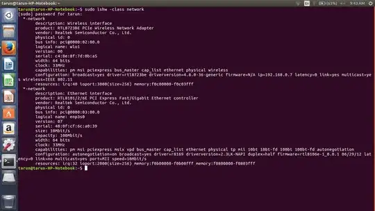

I have an HP laptop dual booted with windows 10 and Ubuntu16.04 LTS. WiFi on Windows works just fine but when I switch to Ubuntu, the network which was showing strong connection in Windows shows weak in Ubuntu. Sometimes it also refuses to connect. Can you please help?
Screenshot

Try this,
sudo service network-manager restart
OR
This done not working fine try below,
Hi, The special version 2 is for 64bit Ubuntu 12.04, Ubuntu 14.04 and above use the regular broadcom-kernel-source driver. From a working wired connection... Please open a terminal .. ctrl+alt+t .. and do...
Ignore file not found or errors..`
sudo apt-get remove --purge broadcom-kernel-source
sudo rm -rf bcma
then do,
sudo apt-get update
sudo apt-get dist-upgrade
sudo apt-get autoremove
sudo apt-get autoclean
Then install the wl driver..
sudo apt-get install --reinstall broadcom-kernel-source
sudo modprobe -v wl
