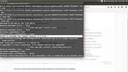

When ever I install a packaage (application) through terminal. it gets install but I'm not able to find it at my desktop, As you can see winff is installed:

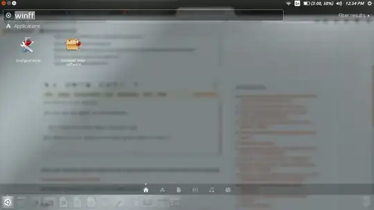

However when I try to search it in dash I'm not able to find it:

You can simply use:
whereis <packagename>
and that should show you a path to the package. If you want to have it on the desktop you can just create a link to the executable file, make a script running that file or use the linux implemented "add to desktop" function.
There are several ways to find about it. Before going farther you should know that some package does not come with binary files thus there is nothing to run with their name.
First we can use whereis command, it will tell us where a command's (not package) binary, source and manuals are located. you can run it like:
whereis perl
to get all information mentioned above about a command named perl, or like:
whereis -b perl
to only get the path of all perl binaries.
Another option is to use which, when I've got multiple binaries for a command, which tells me which one of them will be executed if I run that command, e.g:
which python
For packages, it's a different case; A package can involve multiple and completely different binaries.
one thing we can do is to use dpkg -L <package-name>, it will show all installed files from the package named <package-name>, eg:
dpkg -L coreutils
If I want to get a list only for binaries I can run it like this:
dpkg -L coreutils | grep /bin/
which outputs something like:
/bin/rmdir
/bin/uname
/bin/ln
/bin/cat
/usr/bin/nl
/usr/bin/arch
/usr/bin/tac
We can also use Ubuntu online packages list to search for a package, for your package winff:
http://packages.ubuntu.com/yakkety/all/winff/filelist
At the end if I want to have an icon for fast access to that application I can write a .desktop file for that command, here is more information about creating this files.
