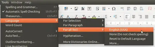

I tried Brayden's answer but I also had to go to Tools > Language > For all Text > English (USA) to get it to work.

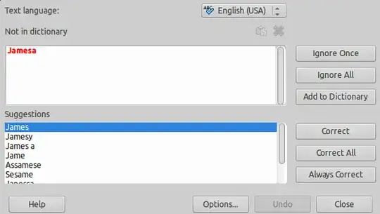

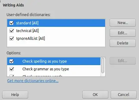

First make sure the functionality of spell checker is enable. You can simply use Shift+F7 to turn it on or off. Or from tools menu > Automatic spell checking.
Then press F7 to open spelling and grammar window.
Make sure "Text language" is selected correctly; use available options to correct the spells.
Other languages dictionaries are available from here.
You can also click on "options" to make sure if necessary options are enabled:

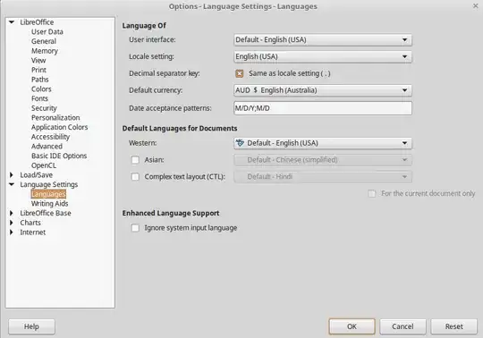

HI If you leave user interface as " Default - English(USA)" and or locale setting as " Default English (UK) " spell check wont work. Choose from the drop down menus so it just says " English (USA) " and " English(UK)" and not the "default" bit then restart LIbreoffice and checker will work.
I had exact same issue and the default settings did not work for me. This worked for me. Even hunspell or myspell, as suggested by Aaron and some others, didn't work.
However adding this extension to Libre Office worked for me: https://extensions.libreoffice.org/extensions/english-dictionaries/ First download it to your computer and then in Lbre Office to go to Tools > Extension Manager > Add > {upload extension file}. Restart application.
You have to set you default language to English US: Open Libre Office > Options > Tools > Language Settings and set you language to English (USA).
