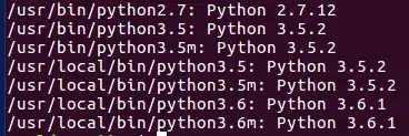

I've installed a few version of Python on ubuntu 16.04 LTS, please see a screenshot.
When I tried to delete/uninstall one (not 2.7.12)-> I broke my system, then recovered again.
Is there any way to remove all versions of Python except core 2.7.12 safely / not breaking any dependencies and system?

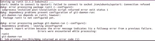

Plus I have problems with zlib1g-dev now: enter image description here
