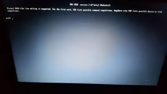

I have a dual booted pc. I tried to uninstall Linux by deleting the partition.
When I boot my pc, there is an error as shown in the attached picture:
this
How can I fix this?
Same thing happened to me because of the UEFI installation. I solved it with reinstalling Linux with deleting it's partition and creating another one to install it with forcing the UEFI installation.
If you had encountered this message box while installing you can try this method I wrote down below.
Firstly, you need a bootable - Linux installed USB drive.(I'm assuming you have it.) Then after booting your PC you need to install GParted from : http://gparted.org/download.php (select the correct Linux Distribution)
After that, you can delete the partition you used to install Linux. Then reboot your PC and install Linux again with forcing the UEFI installation.
