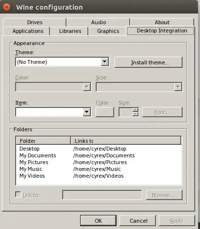

Note that Wine has a Desktop Integration feature where as, even if you change the C: drive to something inside the Wine folder (Instead of the default drive c), it will still be able to reach your Linux Home folder since it maps to your home folder for documents, videos, download, saving game files, etc.. This needed to be explained since I was send a video about a user testing WCry and he changed the C Drive to "drive_c" which is inside the ~/.wine folder but he still got affected on the home folder.
My recommendation if you wish to avoid or at least lower the impact on your home folder when testing with wine is to simply disable the following folders by pointing them to the same custom folder inside the wine environment or to a single fake folder anywhere else.
