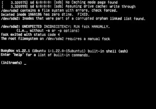

I recently installed Ubuntu and on every boot I see this:
    /dev/sda2: UNEXPECTED INCONSISTENCY; RUN fsck MANUALLY.
        (i.e., without -a or -p options)
fsck exited with status code 4
The root filesystem on /dev/sda2 requires a manual fsck
After running fsck manually Ubuntu boots normally clean, however after boot, I see the lock icon on all folders in my system and none of the apps run. I also started seeing issues with my web browser: Firefox is already running, but is not responding
I'm not sure what's wrong here. I have been running fsck manually and booting.

UNEXPECTED INCONSISTENCY; RUN fsck MANUALLY error message:
Results of running fsck from a live USB:
ubuntu@ubuntu:~$ sudo fsck /dev/sda2 fsck from util-linux 2.27.1 e2fsck 1.42.13 (17-May-2015) /dev/sda2 contains a file system with errors, check forced. Pass 1: Checking inodes, blocks, and sizes Inodes that were part of a corrupted orphan linked list found. Fix<y>? yes Inode 1060186 was part of the orphaned inode list. FIXED. Inode 1060191 was part of the orphaned inode list. FIXED. Inode 1060193 was part of the orphaned inode list. FIXED. Inode 1060200 was part of the orphaned inode list. FIXED. Deleted inode 1060223 has zero dtime. Fix<y>? yes Pass 2: Checking directory structure Error reading block 4202608 (Attempt to read block from filesystem resulted in short read) while reading directory block. Ignore error<y>? yes Force rewrite<y>? yes Directory inode 1048767, block #0, offset 0: directory corrupted Salvage<y>? yes Missing '.' in directory inode 1048767. Fix<y>? yes Setting filetype for entry '.' in ??? (1048767) to 2. Missing '..' in directory inode 1048767. Fix<y>? yes Setting filetype for entry '..' in ??? (1048767) to 2.
Pass 3: Checking directory connectivity '..' in /home/faisal/.cache/logrotate (1048767) is <The NULL inode> (0), should be /home/faisal/.cache (1048583). Fix<y>? yes Pass 4: Checking reference counts Inode 2 ref count is 23, should be 24. Fix<y>? yes Inode 1048583 ref count is 19, should be 18. Fix<y>? yes Unattached inode 1060211 Connect to /lost+found<y>? yes Inode 1060211 ref count is 2, should be 1. Fix<y>? yes Pass 5: Checking group summary information Block bitmap differences: -(79757831--79757834) -(79757837--79757840) -(85494803--85494806) -(85524993--85525000) Fix<y>? yes Free blocks count wrong for group #2434 (21451, counted=21459). Fix<y>? yes Free blocks count wrong for group #2609 (6147, counted=6151). Fix<y>? yes Free blocks count wrong for group #2610 (29311, counted=29319). Fix<y>? yes Free blocks count wrong (105800045, counted=105799995). Fix<y>? yes Inode bitmap differences: -1060186 -1060191 -1060193 -1060200 -1060223 Fix<y>? yes Free inodes count wrong for group #129 (4724, counted=4729). Fix<y>? yes Free inodes count wrong (28871737, counted=28871728). Fix<y>? yes
/dev/sda2: ***** FILE SYSTEM WAS MODIFIED ***** /dev/sda2: 578512/29450240 files (0.4% non-contiguous), 11994565/117794560 blocks

I had a similar problem the reason was the bad health of HDD, as soon I replaced it with new SSD and made a clean install of ubuntu the problem is gone.
If was due to bad sectors on HDD, this I verified from a windows tool Hard Disk Sentinal. As far I know the bad sector can not be removed everytime sometime it's due to physical damage to disk. Also my HHD was 5+ year old and reached it's life time writes.
In my new SSD I made a clean install of ubuntu 21.04 and it's works smooth.
I hade given same answer in Unix Stack Exchange.
type fsck /dev/sda2 and press enter whenever the terminal asks for input.
Now after the process finishes, type: reboot
After rebooting, open the terminal. Make sure you have internet connectivity and type:
sudo apt-get clean
sudo apt-get update
sudo apt-get updrade
Now, your system will start normally from now on.
