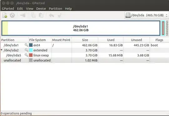

I'd highly recommend runnning
sudo apt update && sudo apt install gparted
then running "gparted" from your start (after entering your password) it'll open this :
gparted up and running
From here you can select your hard drive, you'll be able to tell which is which mainly from the size but the partition types also help.
From there interactively either with the list or with the graphic you may resize partitions (even live ones) to create empty space. and create a new partition in that empty space.
The green check mark or "Apply" is required for the changes to take place.
