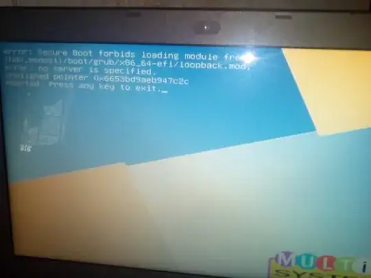

I want to install Ubuntu 14.04 to a new Acer Aspire E 14 using a bootable pen drive. When I select the ubuntu os iso file from multisystem the PC shows this error:
error:Secure Boot forbids laoding module from
(hd0,msdos1)/boot/grub/x86_64-efi/loopback.mod.
error: no server is specified.
unaligned pointer 0x6653bd9aeb947c2c
Aborted. Press any key to exit._
screenshot
I have installed Ubuntu in legacy mode and Windows does not appear even in the grub menu. WiFi is not working either.

If your windows is installed under UEFI, you will have to install Ubuntu under UEFI too to make dual boot work.
To get over the boot problem, you will have to disable Secure Boot in UEFI setup .. in what in the old days was called bios-setup .. not disable UEFI itself.

Its says you need to go into your bios and disable/ turn off secure boot option
