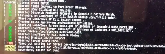

I tried removing and installing 16.04 instead but the same issue. So then I went into recovery mode and ran fsck and got
screenshot
This then paused a for a while before flashing up more error yellow errors that I didn't have time to read before going black and freezing
