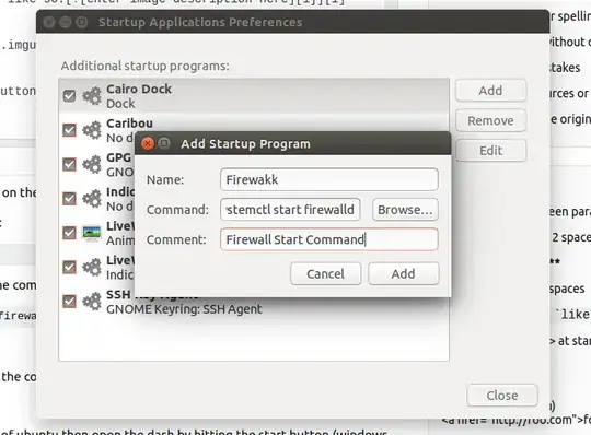

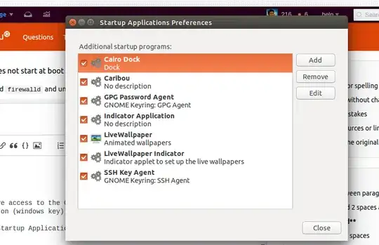

If you have access to the GUI of ubuntu then open the dash by hitting the start button (windows key).
Type in startup Applications and click on the startup applications icon.
You will get as screen like so:enter image description here
Click on the Add button and Add the command like so:
And click Add.
You are good to go.
