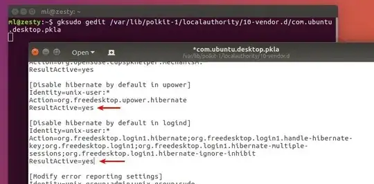

Allow hibernation from top panel buttons
Open the file :
sudo gedit /var/lib/polkit-1/localauthority/10-vendor.d/com.ubuntu.desktop.pkla
and find both sections :
  • [Disable hibernate by default in upower]
  • [Disable hibernate by default in logind]
and change both values from no to yes : enter image description here
