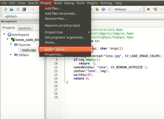

Step 3: Open CodeBlocks and create an OpenCV project
Step 4: After creating the project go to Project >> Build Options

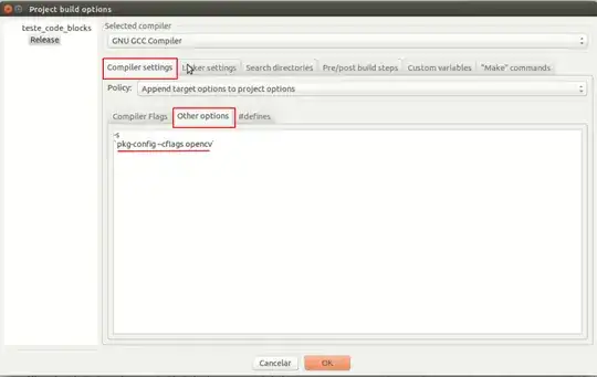

Step 5: On this window,go to compiler settings >> Other options
Here you will see -s on the box. Type this under -s(like picture)
`pkg-config --cflags opencv`

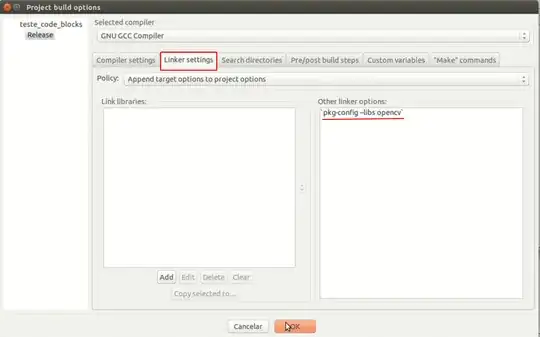

Step 6: Now go to Linker settings >> Other Linker Options
On the blank box copy these line and click OK
`pkg-config --libs opencv`
Now Build and Run the project. It should run.
