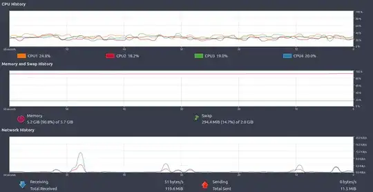

I just opened my system monitor & noticed something odd. See this:
What is odd is that the system ram is almost completely used up, however, swap is hardly touched. Why is the system not migrating some files to swap?
Digging deeper, it appears Firefox-Dev is the culprit here. However, I am hesitant to purge it. Are there any recommendations on resolving this memory issue?
P.S: This is with my system on for 5min, I pretty shutdown whenever I am not using it.
UPDATE:
In response to Ravexina's reply, here is a better picture of stats at this moment, this is while I have atom (IDE) not open. The system is functioning fine right now, I guess my alarm is that Firefox is consuming too much.

Instead of using system monitor, use some utility specially designed to monitor memory usages; Things like free or vmstat.
If you run a command like free -h, you'll get an output similar to:
             total     used     free      shared  buff/cache  available
Mem:         6G        1G       5G        65M     3G          4G
Swap:        4G        0B       4G
As you said:
What is odd is that the system ram is almost completely used up.
It's actually not true, a lot of your memory is being used for buffering and caching stuff, that means they are available for use in case of any need. Linux just uses them to efficiently use all available memory. Pay attention to the “available” column.
The “used” column is the actual amount of memory is being used by your programs.
And about the swap, it will only be used when you are out of memory, say your “used” columns is almost close to your “total” or in any other similar situation. E. g. I've got 8G of swap and it's almost always not being used.
When your cache is being used heavily, it's a sign that something is wrong with memory; Maybe we don't have enough memory etc. And it will slow down the system cause you are using a part of your hard drive instead of a RAM memory which is pretty slow in comparison of a RAM.
So I don't think your problem is related to swap NOT being used, it might be swap being used because you are out of memory.
Check how much free memory you actually have and what processes are using it, that might be helpful to solve your problem.
I guess it's enough to guide your question. ;)
