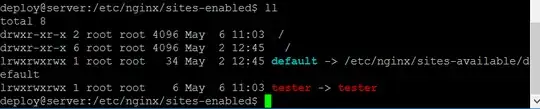

I'm working through https://www.obeythetestinggoat.com/book/chapter_manual_deployment.html#_deploying_our_code_manually, trying to set up a django app on an ubuntu 16.04 VPS. I've followed the directions on setting up an nginx config file. Following the directions I have set up a basic nginx config file and put in in /etc/nginx/sites-available/tester. Now I'm trying to symlink it to /etc/nginx/sites-available/
deploy@server:/etc/nginx/sites-available$ sudo ln -s tester /etc/nginx/sites-enabled/tester
But I'm suspecting that Something is wrong because the link looks different than the default link.
Also after reloading Nginx with:
sudo systemctl reload nginx
The site did not work. I checked :
sudo nginx -T
but don't see the config file. What am I doing wrong. What do the colours mean?
