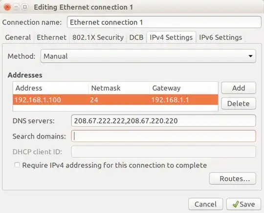

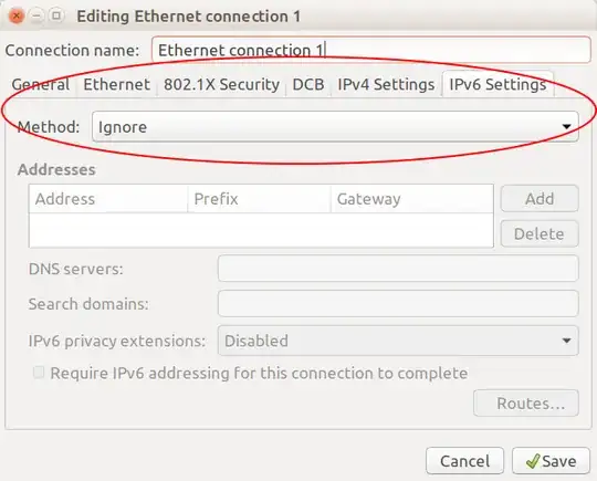

Since you're running Ubuntu Server, then please see Disabling IPv6 on a single interface. And, you'll also want to add dns-nameservers to your interfaces file.
If you're running standard Ubuntu, then delete your changes to /etc/network/interfaces and setup a standard network connection profile to use DHCP to set your address (or manually set an address if you must) and DNS servers (comma-separated list), in the IPv4 tab, and set your IPv6 tab to Ignore...
