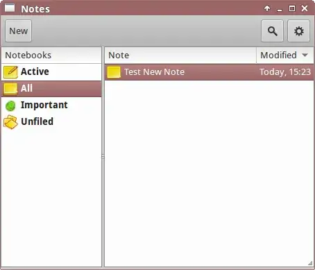

First, create a new note in Gnote by clicking New button in headerbar or toolbar, or click Gnote menu ➜ New note (appearance may vary by desktop environment).
Then, change the note title from "New Note 1" to title of choice i.e. "Test New Note". The title is not case sensitive i.e. "new note" and "New Note" are same in Gnote.
Open a Terminal or an application launcher, type the command i.e. gnote --open-note="Test New Note" and press Enter key. The note i.e. "Test New Note" will open directly.

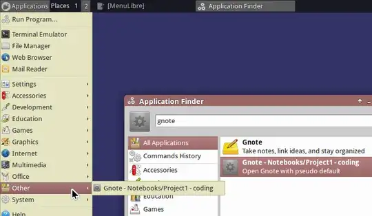

To open Gnote with the pseudo default note, user can either use system-wide application shortcuts, or use application menu (configuration may vary by desktop environment).

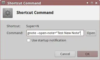

Using system-wide application shortcuts, for example, I have assigned Super+N as shortcut to run the command.
Using application menu, for example, I have created a new launcher using MenuLibre menu editor and the launcher is accessible from both application menu and application launcher.

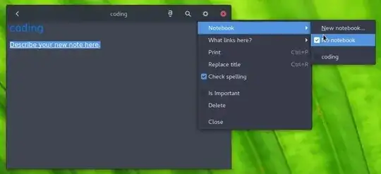

Then, create a new note and change the title i.e. "coding". Close the note and Gnote window. This time, to open the "coding" note, append the earlier option --open-note=title.
gnote --note-path="Notebooks/Project1" --open-note="coding"
