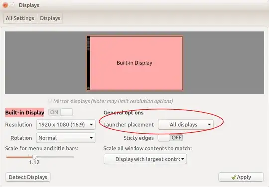

What I want is my primary display to be the laptop display, with my launcher panel showing on the primary display. What is happening is my primary display sets to the laptop but my launcher panel always throws to the left monitor when I set the monitor arrangement in display control panel as described above.

Go to System Settings/Displays, and toggle the setting circled below, to the desired screen.
