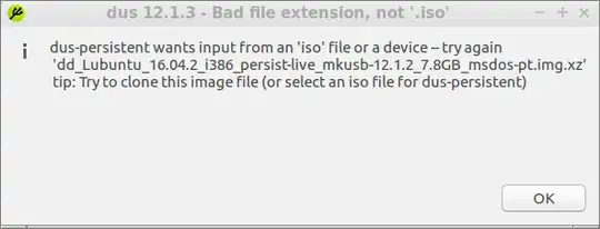

Edit 1: bugfix to make mkusb explain and help solve this issue
Thinking twice about your question, I realize that this is confusing. So I have started to improve the code in the menu part, the shellscript dus. Thanks for asking this question. It helps me improve mkusb :-)
Since you are a coder, I want to explain what I am doing. It is not uploaded yet, but I am modifying the function p_persistent which prepares for the call to the shellscript dus-persistent. The version number will be updated to 12.1.3.
There is output, a zenity window and red text to the console window. The variable src_orig is reset to zero length.
I am also adding code to skip to cloning (calling the function p_live) in the main section of dus (near the end of the shellscript file), if dus is called with a file name as parameter, and the file extension is not iso.

Edit 2: mkusb 12.1.3 is uploaded
I hope that the new version, mkusb 12.1.3, will make things less confusing. It is uploaded to ppa:mkusb/unstable and to phillw.net. Please try it and report back :-)
