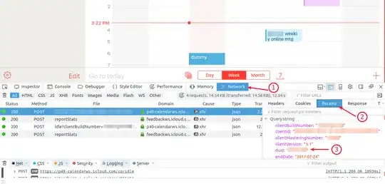

To determine the relevant parameters, first logon to your account on icloud.com, then launch the Firefox web debugging console (F12). The steps are depicted on the below screenshots which show the web debugging console below the iCloud calendar page. With the "Network" tab selected -step (1)- generate some traffic against desired calendars (eg: create a dummy appointment). Look for the corresponding POST (or GET) interactions.
  • The DSid parameter is some sort of numeric userID so it will be the same for multiple calendars/tasklists owned by the same account. Flip to "Parameters" -steps (2) & (3)- to reveal it. Determining 'dsid'
  • The pGUID varies from calendar to calendar (it could simply be "Home" or "tasks" if you don't have multiple calendars/tasklists setup). It can be peeked from the same interactions, but using the "Response" tab -steps (4) & (5)- You may have to drill down in the JSON structures a little to discover it. Determining 'pGUID'

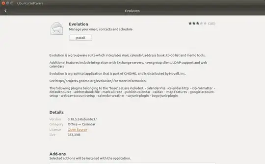

1. Download Evolution mail/calendar client:
Install it from Software Center:
Evolution on Software Center
or run sudo apt install evolution.

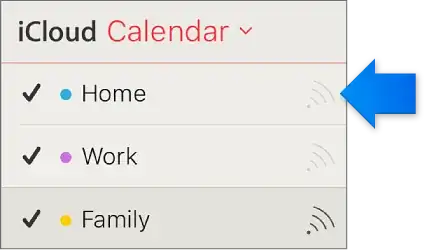

2. Open icloud.com in a web browser and go to your calendars. Click on the circular wireless icon to the right of the name of the calendar you want to use.
ICloud share icon
The calendar you want to use must be shared (dark icon). If it's not, you'll be presented with the option there.
3. Once the calendar is shared, note the name of the server right after webcal:// (example: p02-www.icloud.com)

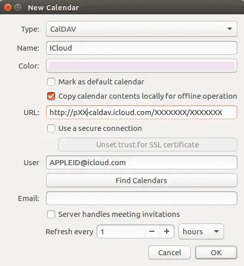

  • File > New... > Calendar
Configure it as:
Type: CalDAV
Enable Copy calendar contents locally... to acces it offline.
URL: If the server was p02-www.icloud.com/abc/123, you would replace www with caldav and enter p02-caldav.icloud.com/abc/123. And it should always look like http://pXX... , not like http://webcal://pXX...
User: YOUR-APPLE-ID@icloud.com
5. Click on Find Calendars, enter your ICloud password and select whichever calendar you want to sync.

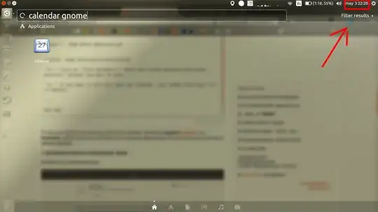

Now your ICloud calendars will appear on Calendar and you will get a preview on the top panel calendar indicator
