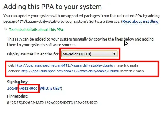

The information is listed on the ppa page in launchpad
Sample screenshot :
So , using the above as an example
sudo apt-key adv --keyserver keyserver.ubuntu.com --recv-keys A9E345C0
See PPA FAQ and Ubuntu wiki secure apt for details
