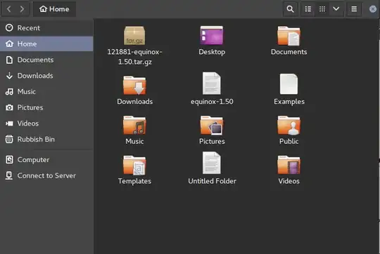

For some reason, these folder icons do not display properly when using Nautilus as a normal user. This is all I see, note the Untitled Folder has no icon:
No Folder Icon - User

Your idea about the file permissions, feels right to me, yet it is not about the file permissions of the folder, but of the image you use for your folder.
If you drag&drop your files, the permissions of the original file stay alive, so if only the user/owner of the file are allowed to read/write, the user on your VM will not have the permissions, as it is a different user.
To solve this issue:
  • either run sudo chown VM-USERNAME YOURFOLDERIMAGE.svg inside the virtual machine, this makes you the owner of the file
  • or give sufficient rights to the file before drag&drop via chmod a+r YOURFOLDERIMAGE.svg, this would give all the permission to read.
The linux file permissions get lost if you use a filesystem not capable of storing them - this is the case with (v)fat(32) and ntfs, which are most commonly used on usb-sticks or external harddrives - therefore your "solution" worked.

So I've got to the bottom of this, kinda.
I cant explain why the icons show for the the root user but not for the normal user, but I've worked out what was causing the icons not to display correctly in the first place.
My Ubuntu runs in a virtual machine. The svg's were created on my host machine and were copied across to the virtual machine using copy/paste, and it seems this is what causes the issue. Not sure why, but I'm accepting it for what it is.
When I upload the svg's to Google drive or similar, or onto a USB stick and download them into the virtual machine, they work fine.
