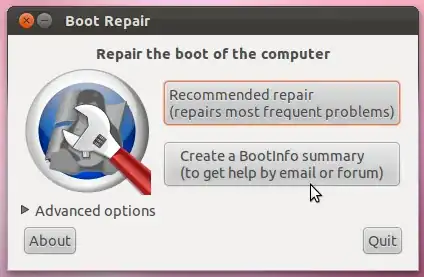

First, and perhaps easiest, would be to try to run boot repair. Boot a live, desktop CD, open a terminal, and run the following commands
sudo add-apt-repository ppa:yannubuntu/boot-repair && sudo apt-get update
sudo apt-get install -y boot-repair && boot-repair
boot-repair
For additional information see - https://help.ubuntu.com/community/Boot-Repair
