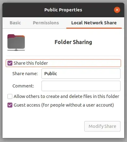

On my Ubuntu 20.04, I can share a folder doing this:
  • Right-click on the folder that you want to share;
  • Goes to tab "Local Network Share" and check "Share this folder";
  • If you don't want to use a registered user, you can check "Guest access (for people without a user account);
  • Click on the button "Create Share".
Maybe some popup will appear to install the necessary software.

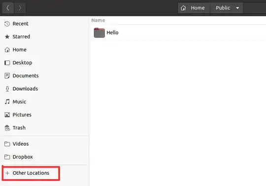

On the other computer you need to enter in your file manager e click on "Other Locations" (if you are using "Nautilus", it is on the left bottom corner) and access the Network from the folder you are sharing.
