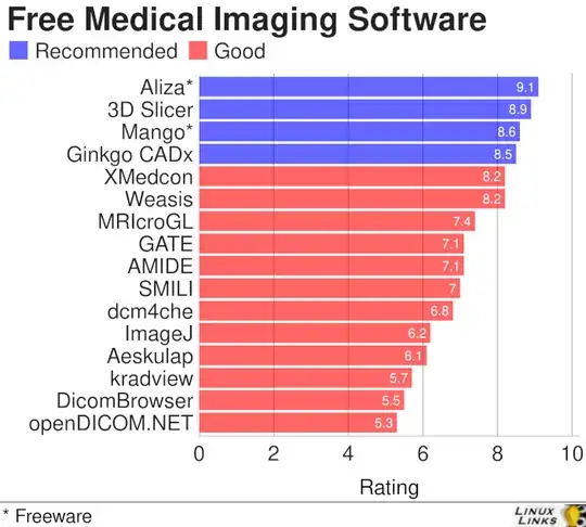

Aliza (on Flathub)
It has free version and non-free version. The source code of the free version is hosted in GitHub.
You can also check this link to find out more options, 16 Best Free Linux Medical Imaging Software
